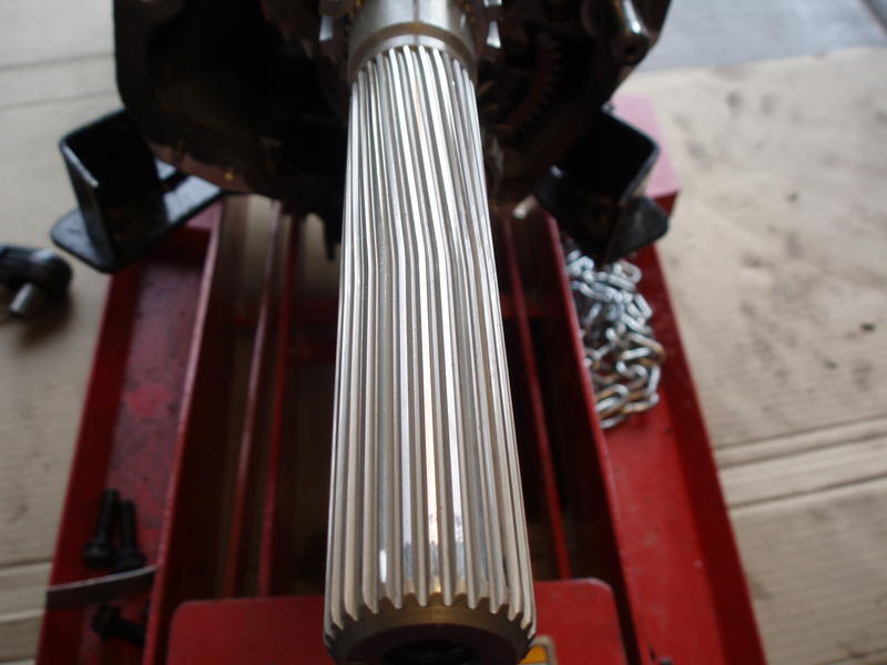

    Starting off with the demolished transmission from last year. This was a built t-56 by the way also. 26 spline input, solid keys blah blah blah

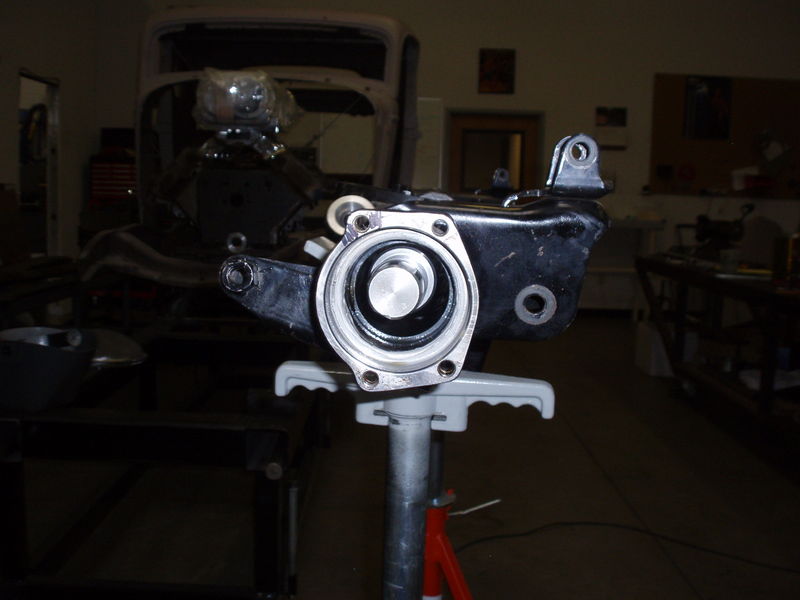

    Here are the fronts installed
    I made mounting tabs for the bulkhead fittings for the transition from the hard line to the braided line to the caliper so the joint would be solid.

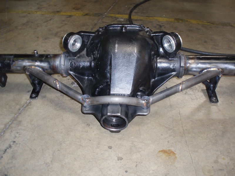

    Here are the rears installed on the freshly rebuilt 8.8. I chose to go with the late big ford 9" ends to fit the brake setup. Got new strange 33 spline axles w/ lightened flanges and 5/8 studs. New lightweight spool and FRPP 4.10 gear set.
    The time came where i decided to go with a different trans. I went to Promotion to have them put together a TKO 600 for me. I got all the goodies in this bad boy. Faceplated, 5th gear delete, cryo'd, etc etc...I ended up getting their hi clamp clutch setup and a QT SFI bellhousing and new cross member
    This is the girdle that clamps to the front of the trans housing to make it stronger
