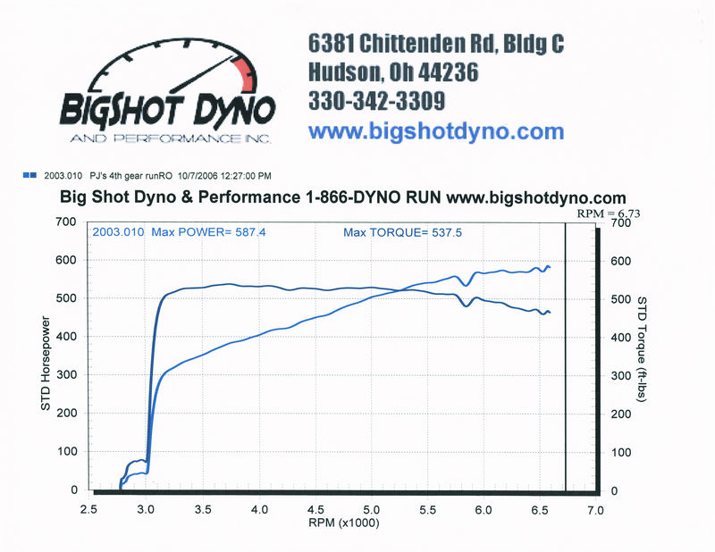

    Went to the dyno today and got the Whipple and my A/F checked.
    My numbers were :
    587.7 RWHP
    537.5 RWTQ
    18.9 Boost (RR 3.0)
    10.8 A/F
    I know that the A/F is rich, but atleast it is not lean. I am going to send my info back to my tuner and have him re-tune it. Then I should hit 600 RWHP.

    Senior Member 50 BMG's Avatar
    770
    Hmm, that A/F is about spot on for 90 octane (the best out here in AZ)

    Quote Originally Posted by 50 BMG View Post
    I was using 94 octane...Should be arround 11.2...
    PJ
    2003 Mineral Grey Cobra
    Super Moderator Gene's Avatar
    1,229
    I'm with james, I'd leave the tune alone since bad gas can be had at any station. Its not my car though. If it make you feel any better, I run 18psi all day long on 91 with 14* timing.
    I run 11.6-11.8 A/F at 19* on 17PSI
    But I always run a can of torco when I fill up so I am probably at 94 octane.
    PJ on 94 octane Sunoco you should shoot for in the mid 11's on the A/F and 19 Degrees on 17PSI.

    The A/F is perfect for out here. I would personally go for methanol injection.
    Congrats PJ2!
    I'm with Jeff. I like 11.5 A/F and 19* on your combo.

    Here is the Sheet...
    PJ
