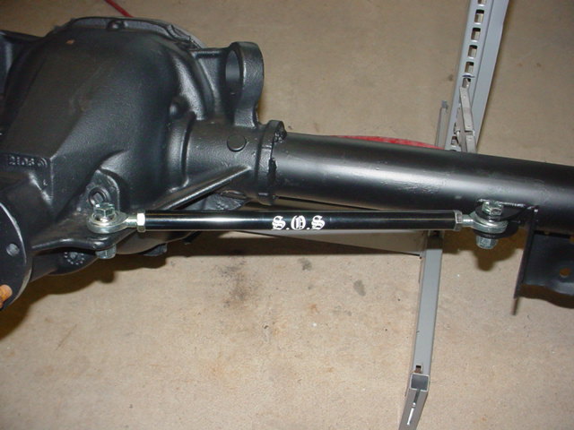

    Wheel I am taking the plunge.
    My Street/Strip Car is Turning into a Strip/Street Car. LOL
    Here is my setup from DTS Custom
    1994-1998 spec 8.8 Housing with welded tubes.
    9" Ends
    GT Brake Brackets for 9" ends
    31 Spline True Trac
    31 Spline Moser Axles w/ 3" studs
    3:73 Gears
    Solid Pinion Shim
    Cobra Pinion Flange
    APR main cap studs
    T/A rear cover.
    No I have to decided on all the other misc stuff that goes with the swap.

    Here's a Rear Disc setup that you can run with those 9" housing ends. It also still incorporates the emergency brake. It's the same kit I went with for my 88 and it only cost me $385. That's about $425 cheaper than what a Aerospace, Willwood, etc. setup will cost you.
    http://www.fordracingparts.com/parts...tKeyField=1790
    Not required. North Race Cars now makes a bracket that allows you to use GT/Cobra calipers with GT rotors and clear 9" ends.

    Cool, but will the exhaust clear those?
    I may go with the CHE brace.
    Then again many people are running no brace with no problems.
    From what I have read, yes. I'm not running tailpipes though, hell, I'm not even running a muffler. My 3-1/2" downpipe is just going to dump just behind the front passenger tire.
    I also just saw in MM&FF I think a company that came out with an under axle brace setup.
    I have a strange feeling I am going to need an anti roll bar. LOL
    Then you can kiss your tailpipes goodbye unless you have them upgrade your housing to a Chris Alston Chassis Works one that runs the anti-roll bar under the axle.
    Miller Race Cars has on that works with stock pipes.
    I believe Steeda has one also that mounts under.
    http://www.millerracecars.net/antiroll.html

    Lou has a Steeda on his and I know he can't run tailpipes with it. They may of come out with a newer one since he put his on though.
