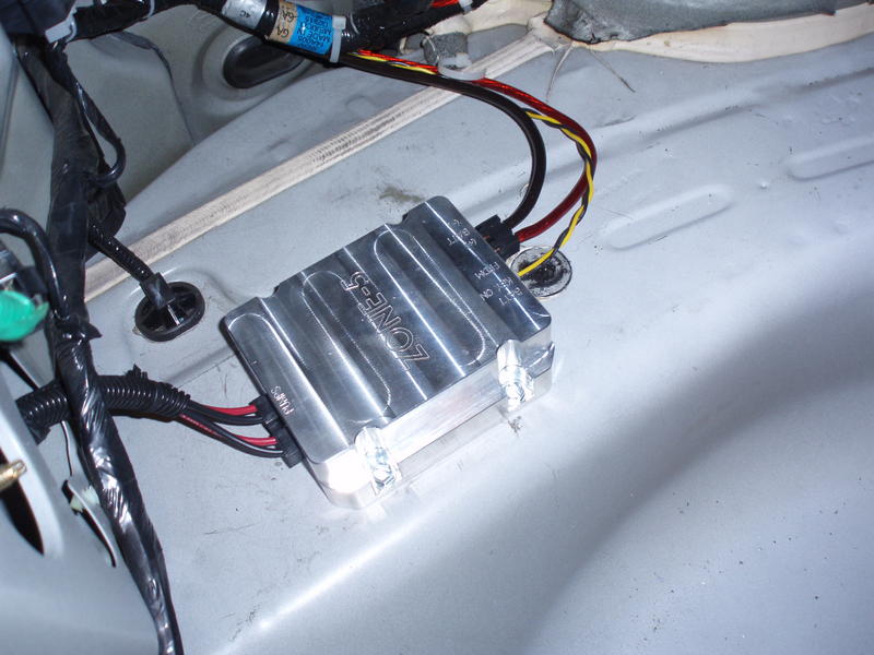

    MDMjr (Mega Driver Module).

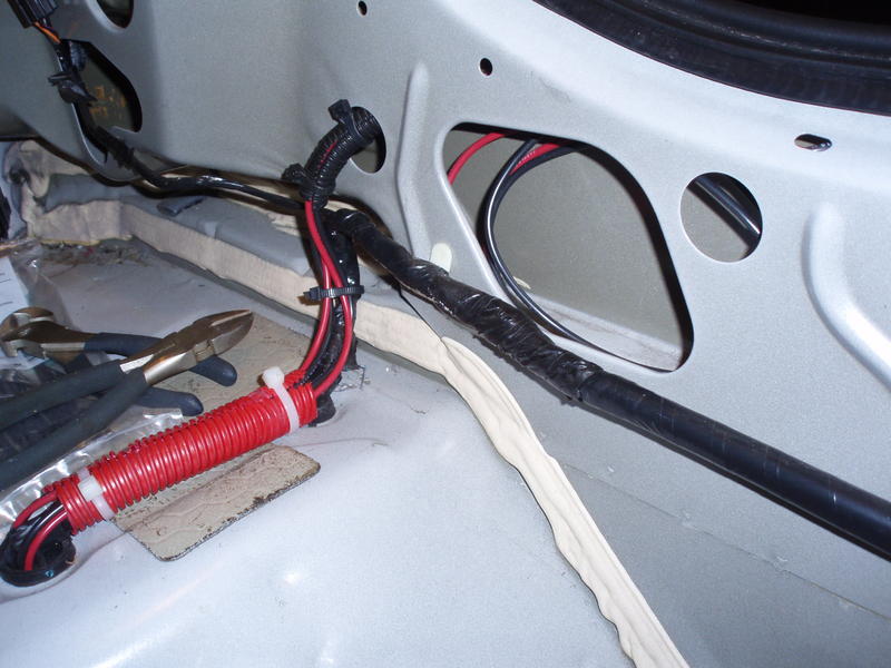

    I am going to trim the carpet away around the MDMjr as it gets a little warm.

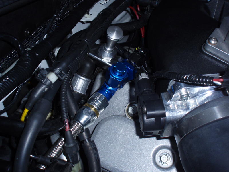

    I placed a T before the rail so I can pump the fuel out before adding race gas.
